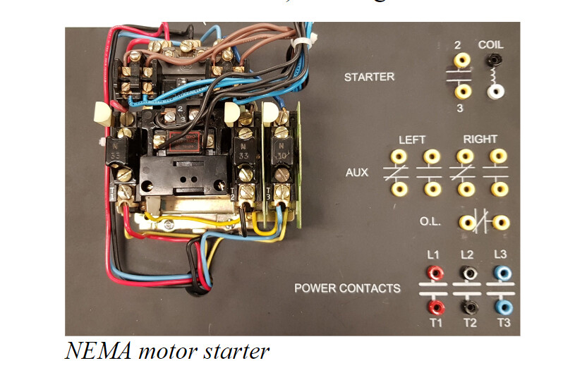

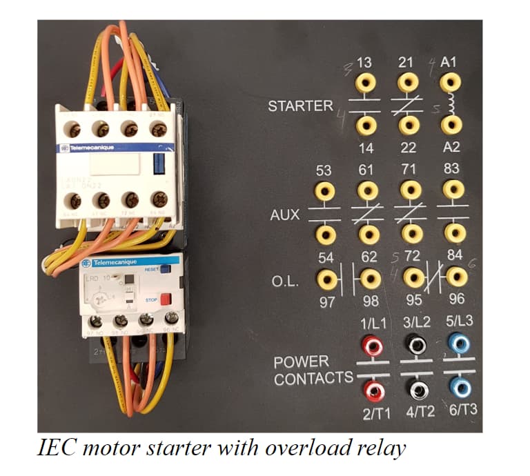

NEMA vs. IEC
The difference between NEMA and IEC contactors is in their certifications and ratings. NEMA (National Electrical Manufacturers Association) is recognized in North America.
IEC (International electrotechnical commission) is recognized in both North America and Europe.
As a general rule, NEMA equipment is more expensive and robust than IEC equipment, but IEC equipment is more versatile. And because is often cheaper, IEC equipment is more commonly seen in modern installations.

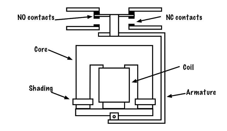

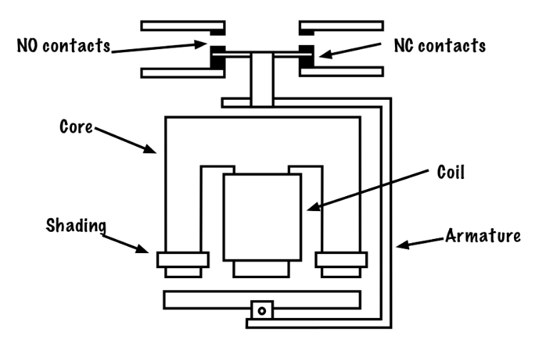

The magnetic contactor is a solenoid relay consisting of stationary contacts that are wired in series with the lines to the motor, an inductive coil wrapped around a magnetic core and a movable armature attached to moveable contacts. When an electric current is passed through the coil of wire, a magnetic field is created. This field, in turn, draws the armature towards it, causing the movable contacts to bridge the gap of the stationary contacts and thus energizing the motor. A spring is constantly trying to open the contacts but as long as there is a voltage present at the coil, magnetic forces will overcome the strength of this spring.
Contactor coil de-energized
Contactor coil energized
When there is a power outage, however, and the current through the coil drops below a threshold, the spring will push open the contacts. If power is restored, the motor load will not re-energize but will instead require further input from the operator. This type of control is called three-wire control and it provides low-voltage protection (LVP).

Sometimes they do! If a magnetic contactor is making an unnatural “chattering” sound, it may be caused by a loose or faulty shading coil. Shading coils are simple closed loops of conductive material that, when exposed to the changing magnetic field of an AC circuit, creates its own magnetic field with a slight delay in period. This allows for a constant magnetic attraction between the moveable armature and the coil of the contactor. If a contactor is “chattering,” it may need its shading coils repaired or replaced.
The overload relay (OLR) is similar in design to that used in manual motor starters. The key difference is that the normally closed contacts of the OLR are wired in series with the current that flows through the armature of the contactor coil. This ensures that if an overload occurs in any of the three power lines supplying the motor, the normally closed contacts of the OLR will open, and the contactor supplying power to the motor is disconnected from the circuit.

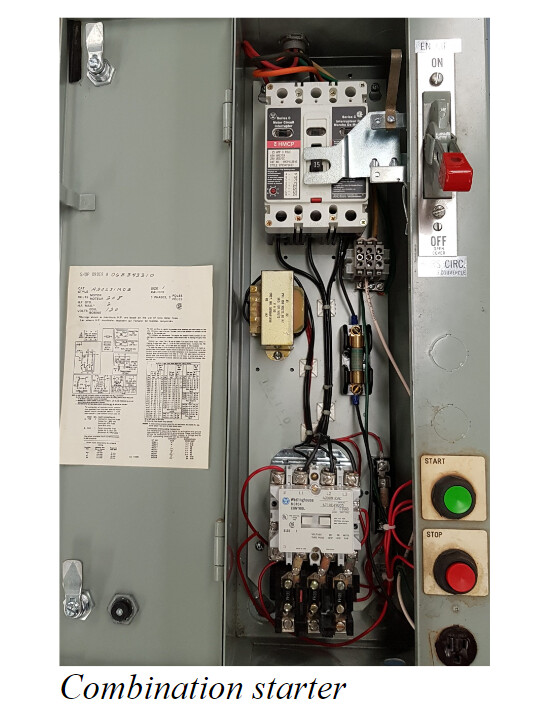

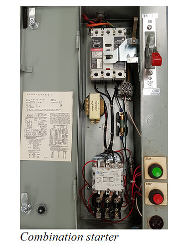

Combination Starters
A combination starter refers to a simplified modular device that contains three-phase disconnects, overcurrent protection, magnetic contactor and overload relays.
