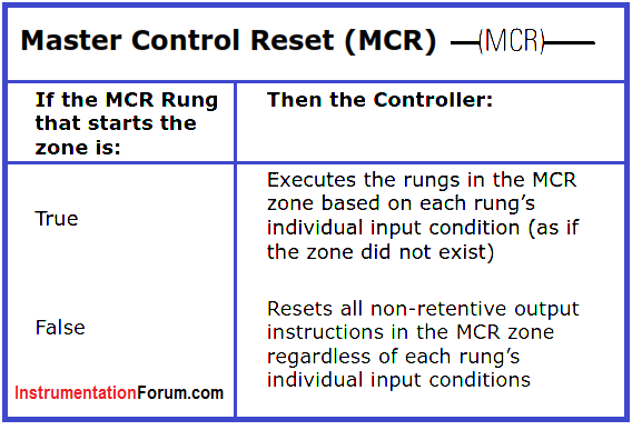

Use Master Control Reset (MCR) instructions in pairs to create program zones that turn off all the non-retentive outputs in the zone.
Rungs within the MCR zone are still scanned, but scan time is reduced due to the false state of non-retentive outputs
MCR zones let you enable or inhibit segments of your program, such as for recipe applications

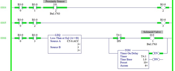

If you start instructions such as timers or counters in an MCR zone, instruction operation ceases when the zone is disabled.
Re-program critical operations outside the zone if necessary.
The TOF timer activates when placed inside of a false MCR zone.
