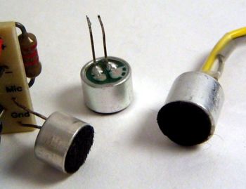

The most commonly used microphones for audio use capacitance charge (condenser microphones), electromagnetic generation (dynamic microphones), or piezoelectric generation. In a [condenser microphone], a thin membrane of the microphone acts as one plate of a capacitor and a nearly constant charge is maintained on the capacitor.
The voltage maintained across the capacitor plates changes with the vibrations in the air, according to the capacitance equation:
[Q = C \cdot V] where Q = charge in coulombs, C = capacitance in farads and V = potential difference in volts, resulting in a change in output voltage.
Power is necessary for establishing the capacitor plate voltage, and is also needed for internal amplification of the signal to a useful output level. Electret microphones, a type of condenser microphone, replace the externally-applied charge with a permanently fixed-charged material.
The electret is a stable dielectric material with a permanently-embedded static charge. Electret microphones require no polarizing voltage but, due to their integrated pre-amplifier, require a small amount of power either from microphone inputs as phantom power or from a small battery. Due to mass-production of these devices, electret microphones lack the precision needed for high-quality microphones.
