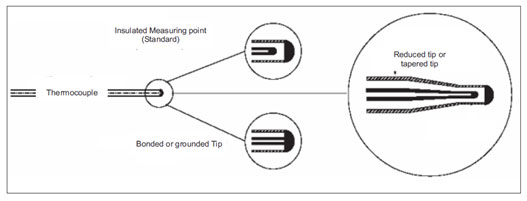

The junction tip of Mineral insulated thermocouple can be of three types as described previously. The tip can be insulated, grounded and reduced type.
- Insulated Tip: Insulated hot end junctions are suitable for most applications, especially where low EMF pick-up is essential. High insulation resistance is enhanced due to extreme compaction of the high purity MgO powder insulation.
- Bonded or grounded junctions offer a slightly faster temperature response than the insulated junction type. Not recommended for multi-point instrumentation.
- Reduced tip junctions are ideal for applications where low mass and extremely fast response times are required, together with good mechanical strength. Reduced tip can be provided on 1.0 to 6.0 mm diameter thermocouples.
