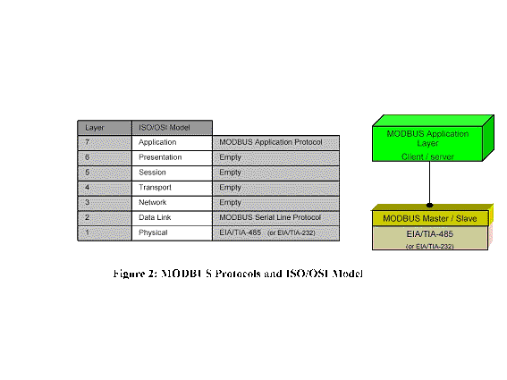

MODBUS Serial Line protocol is a Master-Slave protocol. This protocol takes place at level 2 of the OSI model.
Standard Modbus ports on Modicon controllers use an RS–232C compatible serial interface that defines connector pinouts, cabling, signal levels, transmission baud rates, and parity checking. Controllers can be networked directly or via modems.
The following figure gives a general representation of MODBUS serial communication stack compared to the 7 layers of the OSI model.
Modbus OSI Model
