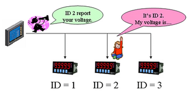

Modbus RTU Protocol Overview
Modbus RTU is a master-slave protocol. This means that only one device, the master , is allowed to initiate communication. The other devices on the network are called slaves and they may only respond to the requests.
Modbus RTU can support up to 247 devices on the same physical network. It’s possible to modify the protocol to support more slaves, but in most applications the standard limit of slaves if enough.

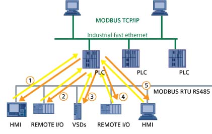

Modbus TCP
Modbus TCP is an adaptation of Modbus to be used on top of modern TCP/IP networks. There are two types of Modbus TCP implementation:
  • Modbus RTU over TCP, which simply uses TCP as a transport layer for RTU messages
  • Normal Modbus TCP which has some changes in the message format.
Because Modbus TCP uses Ethernet networks, the data transmission speeds is much higher than in RTU using serial links. The drawback is that TCP/IP stack is much more difficult to support in some types of field devices where Modbus RTU would work fine.

Modbus TCP
Modbus TCP is the protocol designed for transmitting Modbus frames using TCP/IP stack, typically over Ethernet physical layer.
There are two ways Modbus and TCP can work together. One is the actual Modbus TCP protocol, the other is Modbus RTU-over-TCP .
Modbus TCP vs RTU-over-TCP
In both cases, TCP is a transport protocol that carries Modbus messages. But the messages are different.
In Rtu-over-TCP, TCP is used to transport the exact same messages as are used in Modbus RTU (serial).
In Modbus TCP, on the other hand, the message (frame) itself has different structure, so the two formats are not compatible.
