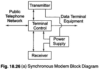

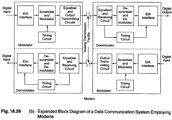

Synchronous modems typically consist of four sections, as shown in Fig. 18.26(a). The transmitter, receiver, terminal control and power supply. The transmitter section of a synchronous modem typically consists of timing (clock), scrambler, modulator, digital to analog converter and equalizer circuits. The expanded block diagram is shown in Fig. 18.26(b). The timing circuit provides the basic clocking information for both the modem and the data terminal equipment (DTE) that is providing the data to be transmitted. The internal timing is usually controlled by a crystal oscillator to within about 0.05% of the nominal value.
Since the receiver clock is derived from the received data, those data must contain enough changes from 0 to 1 (and vice versa) to assure that the timing recovery circuit stays in synchronization. In principle, the data stream provided by the associated terminal or business machine can consist of any arbitrary bit pattern. If the pattern contains long strings of the same value, the data will not provide the receiver with enough transitions for synchronization. The transmitter must prevent this condition by changing the input bit stream in a controlled way. The part of the transmitter circuitry that does this is called the scrambler. Scrambler are usually implemented as feedback shift registers which may be cascaded or connected in series. They are designed to ensure that each possible value of phase angle is equally likely to occur, to provide the receiver demodulator with enough phase shifts to recover the clocking signal. Although scrambling is necessary for the reasons cited above, it increases the error rate, since an error in one bit is likely to cause an error in subsequent bits. To counteract this, some modems encode the input to the scrambler in gray code, so that the most likely error in demodulation will cause only a 1 bit error when decoded at the receiver.
The modulator section of the transmitter converts the bit patterns produced by the scrambling process into an analog signal representing the desired phase and amplitude of the carrier signal. The carrier frequency, baud rate, and number of bits represented by each baud is different for modems of different rates. The modulator collects the correct number of bits and translates it into a number giving the amplitude of the electrical signal that is correct for the carrier frequency and phase of the carrier at that instant in time. Modulation differs for Modem Definition of different speeds, and those made by, from different manufacturers.
The equalizer section of the transmitter is relatively simple, since it can compensate only for the average of expected errors on the output channel. The receiver equalizer, however, must compensate for the actual errors introduced in the transmission path. This is done by using adaptive equalizers which measure errors observed in the received signals and adjusts some parameter of the circuit (usually the receiver clock frequency) to track slowly varying changes in the condition of the transmission line.
At the receiver, the incoming signal from the line is modulated or frequency translated using an internal clock. The resulting intermediate frequency is processed to produce a clock signal at the rate at which the data is actually being received. This signal is applied as the reference to a phase locked loop oscillator. The output of this oscillator is a stable signal locked to the incoming line frequency in both phase and frequency.
The descrambler section of the receiver performs an operation that is the inverse of the scrambler.
