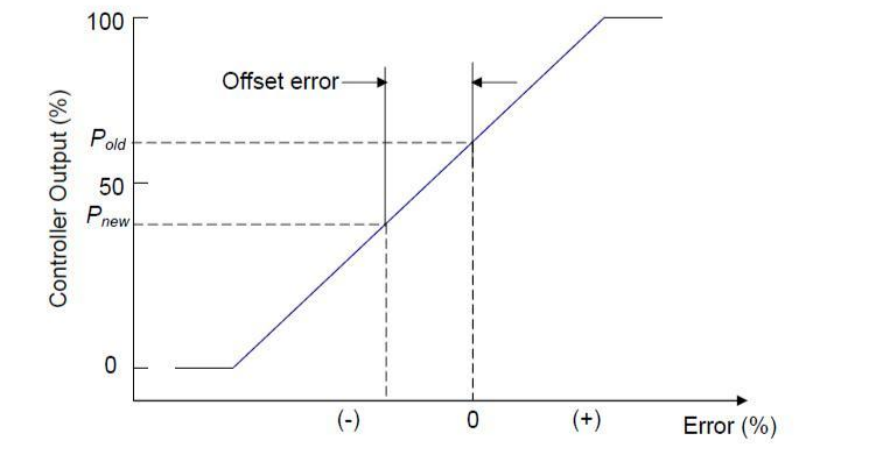

Offset: An important characteristic of the proportional control mode is that it produces a permanent residual error in the operating point of the controlled variable when a load change occurs and is referred to as offset.
It can be minimized by larger constant Kp which also reduces the proportional band.
Figure shows the occurrence of offset in proportional control mode.
Fig. Occurrence of offset error in proportional controller for a load change.
Consider a system under nominal load with the controller output at 50% and error zero as shown in Fig. If a transient error occurs, the system responds by changing controller output in correspondence with the transient to effect a return-to-zero error.
Suppose, however, a load change occurs that requires a permanent change in controller output to produce the zero error state.
Because a one-to-one correspondence exists between controller output and error, it is clear that a new zero-error controller output can never be achieved. Instead, the system produces a small permanent offset in reaching compromise position of controller output under new loads.
