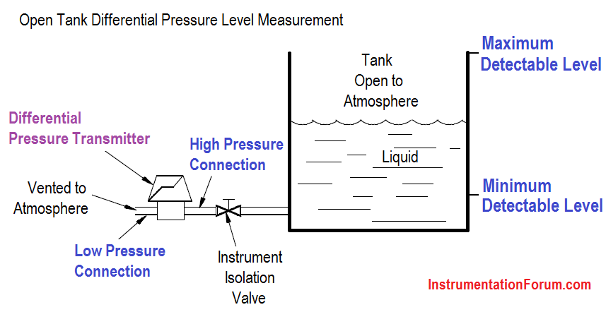

The differential pressure (DP) sensor/detector method of liquid level measurement uses a DP detector connected to the bottom of the tank being monitored.
The higher pressure, caused by the fluid in the tank, is compared to a lower reference pressure (usually atmospheric). This comparison takes place in the DP detector. Figure illustrates a typical differential pressure detector attached to an open tank.
Open Tank Differential Pressure Level Measurement
The tank is open to the atmosphere; therefore, it is necessary to use only the high pressure (HP) connection on the DP transmitter.
The low pressure (LP) side is vented to the atmosphere; therefore, the pressure differential is the hydrostatic head, or weight, of the liquid in the tank.
The maximum level that can be measured by the DP transmitter is determined by the maximum height of liquid above the transmitter.
The minimum level that can be measured is determined by the point where the transmitter is connected to the tank.
