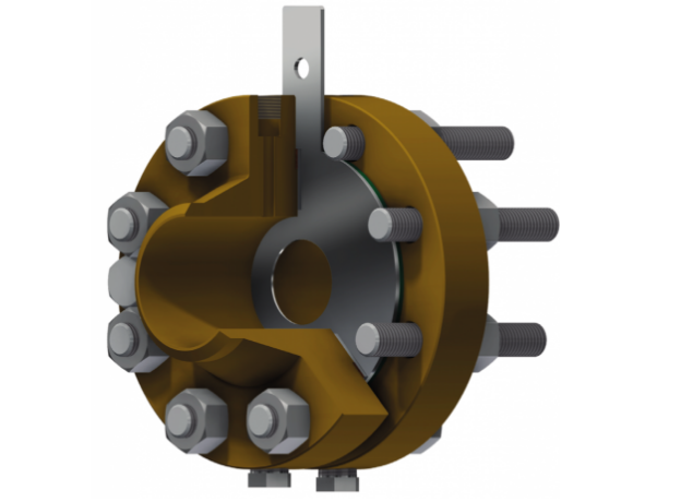

Principally, an orifice plate is a precision instrument. In best circumstances, the inaccuracy of Orifice plates can possibly fall in the range of 0.75-1.5% AR.
However, there are numerous error causing conditions which can terribly affect the accuracy of an Orifice plate…
