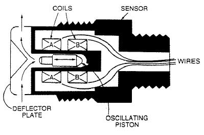

The method involves alternatively energizing two coils, which cause piston to oscillate in cavity.
The movement is opposed by fluid filing cavity.
Thus travel time gives viscosity of liquid.
