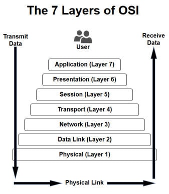

OSI MODEL
International standardization organization understood a need of standardizing multilevel networking which posses’ flexible structure.
Activities and requirements are detailed at each layer.
There are seven distinct layers:
