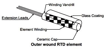

Outer wound RTD element
The outer wound RTD element is made by winding the sensing element wire around a center mandrill, which is usually made of ceramic. This winding is then coated with glass or some other insulating material to protect and secure the windings.
The winding wires are then spot welded to extension leads and secured to the body with ceramic cement or epoxy.
