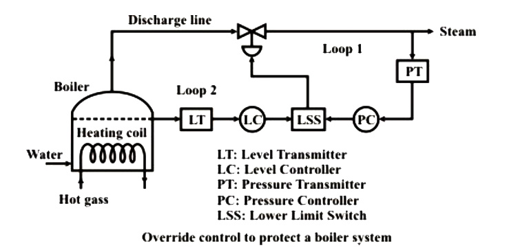

Let us consider a simple example of override control. Consider a boiler system shown in Fig. Under normal circumstances, the steam pressure of the boiler is controlled by controlling the flow through the discharge line.
The pressure is maintained through the pressure transmitter and the pressure controller. But the water level of the boiler should also not fall below a specified lower limit, which is necessary to keep the heating coil immersed in water and thus preventing the burning out.
This can be achieved by using override control through the lower limit switch (LSS). Under normal circumstances, the selector switch selects the pressure control loop for control; but as soon as the level of water falls below a set value, the selector switch switches to level control mode and the second loop takes over the control action.
