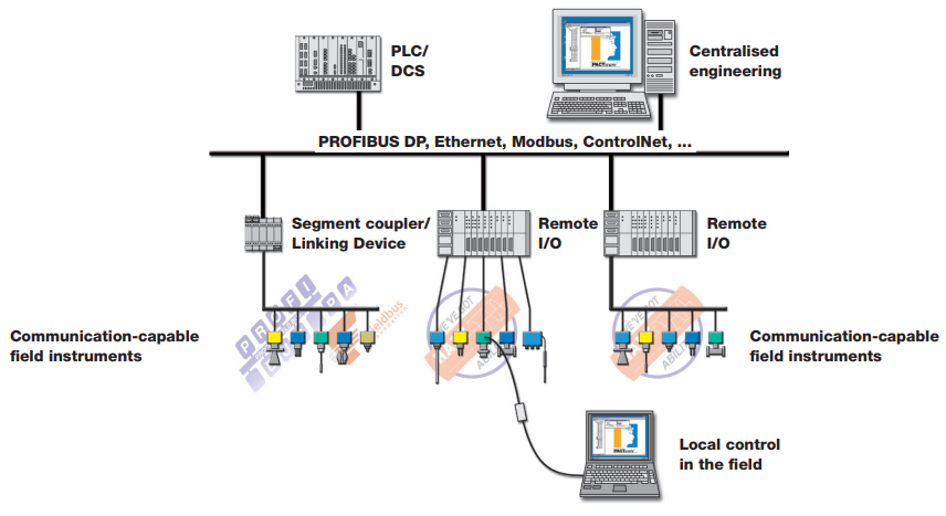

PACT ware is a manufacturer and fieldbus-independent software for operating field instruments.
Up to now it was often necessary to use several different manufacturer-specific programs to operate different field instruments to the full extent. This is no longer necessary, because PACTware enables adjustment of any and all field instruments with only one software tool.
PACTware uses a standardised interface between the frame program PACTware and the individual software modules for instrument operation. This interface is known as FDT; the software modules for instrument adjustment are called DTMs. This configuration makes modern and user-friendly adjustment concepts possible because the interface for instrument adjustment is optimally adapted to each instrument.
Furthermore, you can communicate with PACTware not only via HART but also via any standard field bus system. To this end, different so-called “communication DTMs” are available. In PACTware, these instrument and communication DTMs are assembled individually according to the given requirements.
PACTware enables open, comprehensive adjustment of different field instruments via any bus system.

PACT ware can be implemented in process as well as plant automation. The prerequisite is a bus system that can transmit, apart from actual values (process data), also parameter adjustment data. Communication DTMs are already available for the following fieldbusses and communication types:
- PROFIBUS PA
- HART
- Fieldbus Foundation
- Modbus
- ControlNET
- DeviceNET/CIP
- Ethernet
- AS-Interface
- Interbus
- Standard communication (RS232)
- Various proprietary networks
Thanks Mike. That’s a lot of good information. Have you used PACTware personally? My interest in PACTware is more for calibrating and configuring HART instruments but it looks like only a handful of brands out there support it? But I wonder how well it works and if its just as easy as using a HART communicator.
Yes, it works like HART communicator. It has similar software windows as like field communicator and provides all information as it is.
You have to install in a pc and connect it to your DCS network. IO modules must be HART enabled cards otherwise it won’t work.
Contact your control system vendor whether they supports this software or not. Browse device files or check version info of the software.
