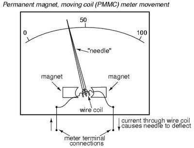

The PMMC instrument is shown in the below images.
The moving coil is either rectangular or circular in shape. It has number of turns of fine wire. The coil is suspended so that it is free to turn about its vertical axis. The coil is placed in uniform, horizontal and radial magnetic field of a permanent magnet in the shape of a horse-shoe. The iron core is spherical if coil is circular and is cylindrical if the coil is rectangular. Due to iron core, the deflecting torque increase, increasing the sensitivity of the instrument.
The controlling torque is provided by two phosphor bronze hair springs.
The damping torque is provided by eddy current damping. It is obtained by movement of aluminum former, moving in the magnetic field of the permanent magnet.
The pointer is carried by the spindle and it moves over a graduated scale. The pointer has light weight so that it deflects rapidly. The mirror is placed below the pointer to get the accurate reading by removing the parallax. The weight of the instrument is normally counter balanced by the weights situated diametrically opposite and rapidly connected to it. The scale markings of the basic d.c PMMC instruments are usually linearly spaced as the deflecting torque and hence the pointer deflections are directly proportional to the current passing through the coil.

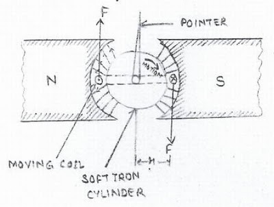

The top view of PMMC instrument is shown in the below image.
