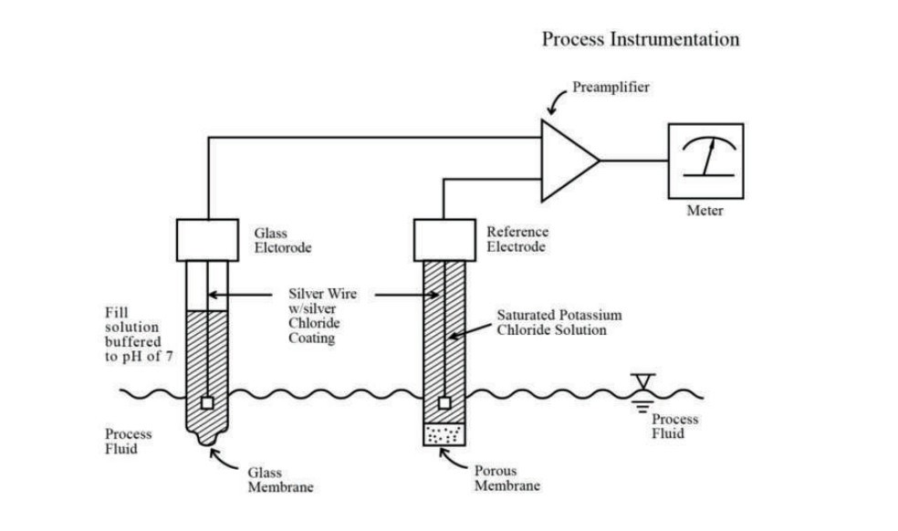

A glass electrode, which is sensitive to hydrogen ion activity, measures the pH of an aqueous solution.
The electrode produces a voltage related to hydrogen ion activity and to pH.
The pH is determined by measuring the voltage against a reference electrode.

A typical pH sensor is shown in Figure.
Source: WEF,2008
