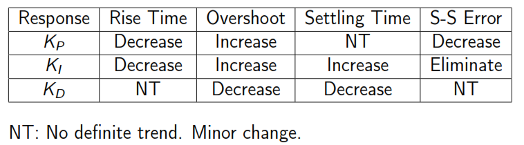

How do the PID parameters affect system dynamics?
We are most interested in four major characteristics of the closed-loop step response. They are
Rise Time: the time it takes for the plant output y to rise beyond 90% of the desired level for the first time.
Overshoot: how much the the peak level is higher than the steady state, normalized against the steady state.
Settling Time: the time it takes for the system to converge to its steady state.
Steady-state Error: the difference between the steady-state output and the desired output.
The effects of increasing each of the controller parameters Kp , Ki and Kd can be summarized as
