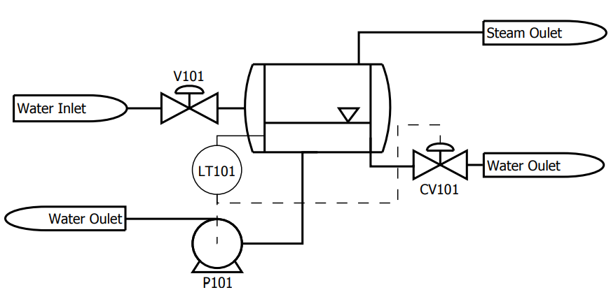

The P&ID diagram should resemble the process flow sheet, but the process information is not shown. Each item shown on the P&ID is given a unique identification number called a P&ID tag, which allows the item to be tracked throughout the design.
P&IDs are developed in steps. First the major equipment is drawn; afterwards all the instrumentation and control equipment is added, often requiring additional space.
Also, P&IDs are controlled documents: control means that there should be verification checking or some other quality assurance procedure to show that P&IDs carry the definitive information from which many design entities draw their work.
An example, using the flasher level control described in the previous section, is shown in Figure.
