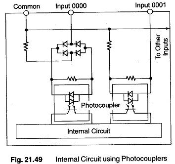

The only thing that is accessible to the user are the terminals labelled common, input 0000, input 0001, input xxxx as shown in Fig. 21.49.
The common terminal either gets connected to V + or ground. The type of sensor used decides where the common terminal is to be connected. When using a NPN sensor this terminal is connected to V +. When using a PNP sensor this terminal is connected to zero voltage (ground).
A common switch (i.e. limit switch, push button, toggle, etc.) would be connected to DC Inputs in a similar fashion. One side of the switch would be connected directly to V + and the other end goes to the PLC input terminal. This assumes that the common terminal is connected to OV (ground). If the common terminal is connected to V+ then simply connect one end of the switch to OV (ground) and the other end to the PLC input terminal.
The photocouplers shown in Fig. 21.49 are used to isolate the PLC’s internal circuit from the DC Inputs. This eliminates the chance of any electrical noise entering the internal circuitry. They operate by connecting the electrical input signal to light and then by converting the light back to an electrical signal to be processed by the internal circuit.
