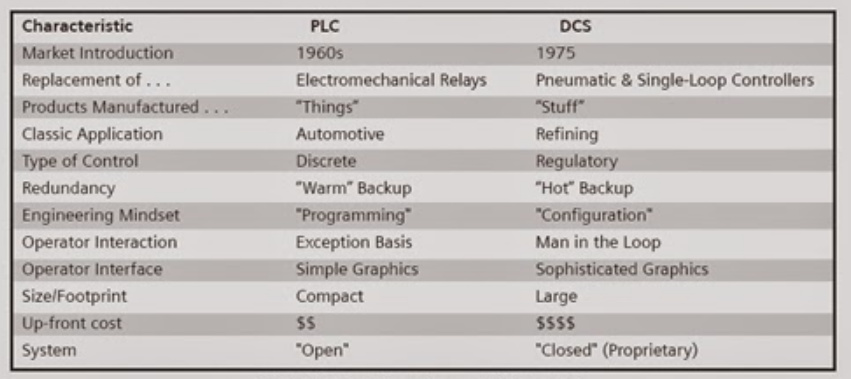

Today, the decision between PLC and DCS often depends on business issues rather than technical features. Questions to consider are those involving:
The internal expertise to execute the project, Level of support available from a vendor/integrator, Long-term maintainability, and Life-cycle costs.
PLCs and DCSs overlap in their features, but also have distinct strengths and weaknesses. When deciding between the two, know who will deliver and support your system, and how they will do it.
