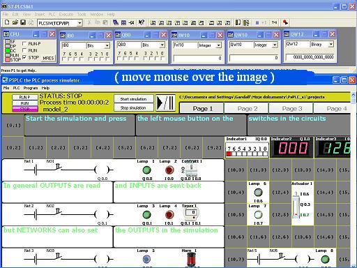

How does the simulator work?
- Similarly to the PLCSIM™ - the process simulator also works in cycles.
At the start of each cycle PS PLC reads both the decimal and analog OUTPUTS then the calculations for every devices are done.
The devices are worked out with the following order: circuits, buttons and switches, components such as: motors, actuators, valves and finally lights, indicators.
At the end of each cycle the process simulator sends all the INPUTS back to the PLC unit. The “PS PLC” works with the ratio of about 10 cycles per second.

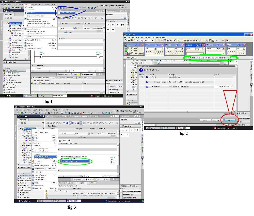

Establishing the connection correctly between PLCSIM and the process simulator while working under TIA Portal.
Select “Cancel” during starting the simulating (fig2), and then download to the PLC the program (fig3)

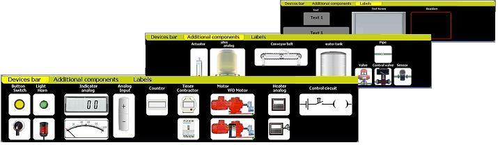

TOOLBARS:
Press the left mouse button on one of the following: “Device bar”, “Additional components” or “Labels” to select the actual toolbar.
Press the left mouse button on the selected item to choose them, then press the left mouse button again on the WORKSPACE to put the object, right mouse button to cancel.

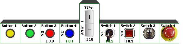

Buttons, switches and analog inputs

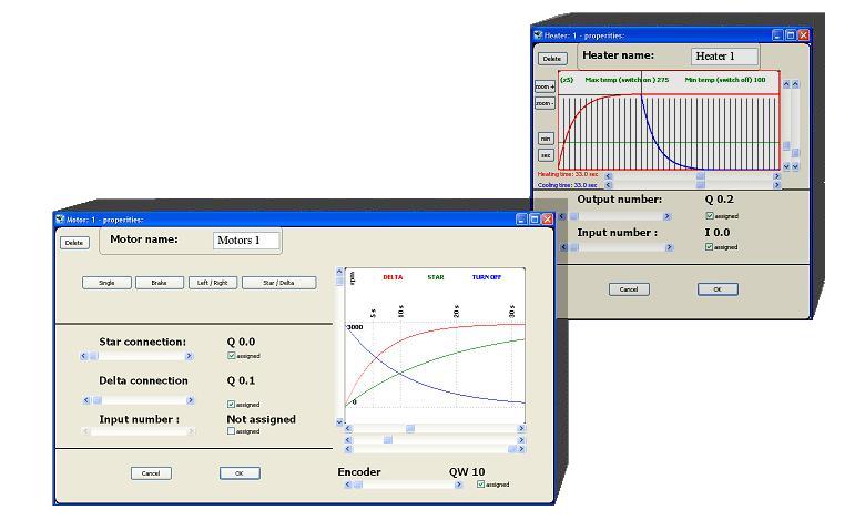

Press the right mouse button during the edition to enter the objects’’ properties. Buttons and switches can be normally open or normally closed.
Analog inputs can be signed or unsigned.
Press the left mouse button on the object during the simulation to change its state or value.
LEDs, Horns, Indicators.
LEDs should be turned on and off only by the OUTPUTs but in the simulation they can be also used for indicating the signal state at the INPUTs.
Timers, Contractors, Counters.
Timers and Contractors are normally open or closed.
Counters can be used to count impulses for a PLC programmer (not the program)
Actuators, Motors, Heaters.

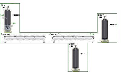

Siloses, conveyors.
Select a SILOS from the toolbar and put it on the WORKSPACE, then press the right mouse button on the SILOS to enter its properties set the SILOS capacity, the colour of material and set up sensors.
In order to place a conveyor select it from the TOOLBAR hold the left mouse button and drag a conveyor towards left or right on the WORKSPACE
Press the right mouse button at the beginning of the conveyor to select the colour and amount of material conveyed, choose between silos or conveyor to specify the source of material taken
Press the right mouse button in the middle to add a DROPPER
Press the right mouse button at the end of the conveyor to set the OUTPUT for driven roller. Unless the material is taken by another conveyor (“Conveyor transports to” - leave disabled) select the destination SILOS

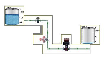

Tanks, pipes, valves, flow sensors.
Select a TANK from the toolbar and put it on the WORKSPACE, press the right mouse button on the TANK to enter its properties adjust the TANK capacity and set up a level sensor.
To lay a pipe select it from the TOOLBAR hold the left mouse button and drag a pipe in any direction on the WORKSPACE.
The shape of the pipe doesn’‘t matter for the liquid flow. Only the settings in the pipe’'s properties are important.
To install a valve select it from the TOOLBAR and put the valve on the straight piece of pipe. (Apart from pipe elbows)
Make sure there is an unoccupied field above or on the left. Flow sensors can be fitted on any straight part of the pipe.
So far only single pipes can be laid (without Y connections). In some cases an additional TANK can be used as the Y connection

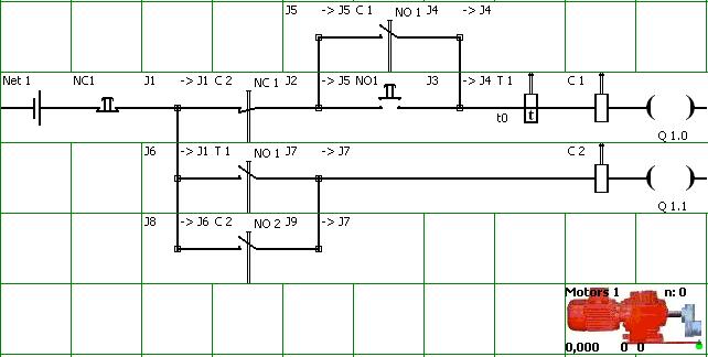

Control circuits.
Control circuits - can be used for building simple control circuits such as junction boxes, control boxes.
A new CIRCUIT can be built by selecting it from the TOOLBAR then holding the left mouse button and dragging the CIRCUIT towards the right on the WORKSPACE.
First of all, the devices on the circuits (BUTTONS, SWITCHES, CONTRACTONS, RELAYS, CONTACTS) are different from the devices on the TOOLBAR
The beginning of each NETWORK can always be powered as if from a battery or fed by a PLC OUTPUT.
Control CIRCUITS are calculated before all other devices in each cycle. (see: “How does it work” at the top of the page)
Only the circuits set the decimal OUTPUTS so that they can be used for turning on and off all other devices or setting the decimal INPUTS ( the example circuit: star-delta motor starter )
(NOTICE. Circuits are not exactly calculated as the single wires.
It is presumed that each part of circuit conducts the electric current if there is a connection with both the begining and the end of the network)
For more complex circuits coils in particularly between the junction points may not work properly )

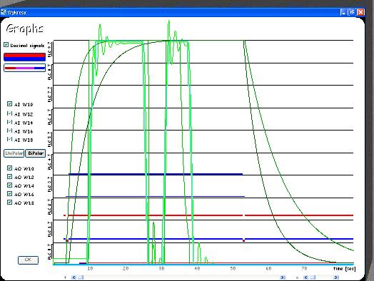

Graphs.
Graphs can be recorded for 1 hour. In order to obtain Graphs for longer last simulations the field “Save Graphs” in “Program Options” should be selected.
Graphs are saved every: 1,2,4,8,16 minutes - depending on the setting the scrollbar of the scale on the Graphs screen.
While the Graph is being saved the PSPLC and PLCSIM is being paused
