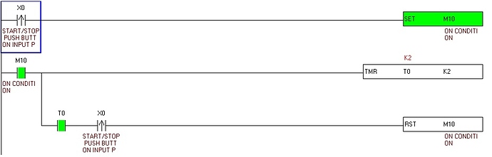

Using PLC Ladder Program start and Stop using single input from Input Port or HMI button.
Using Input Port Push Button switch Start/Stop ladder plc program

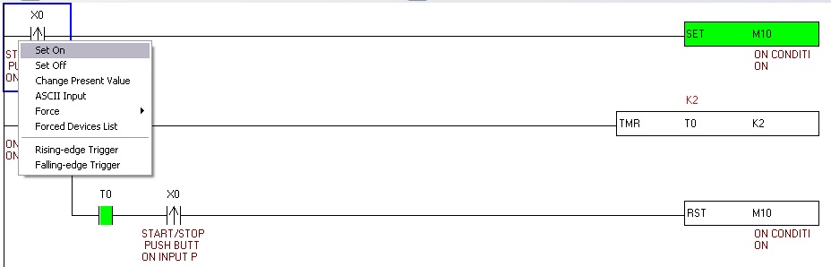

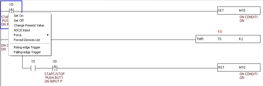

Set by pressing Push button X0 input of PLC port

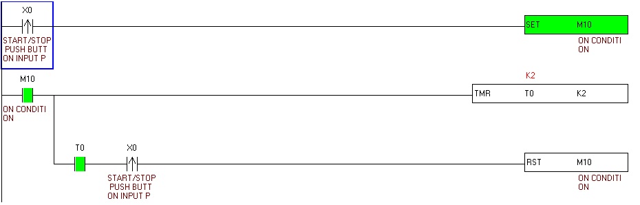

See internal relay(M10) getting On condition from we can use this internal register any of PLC output or machine operation as Start of process.

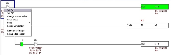

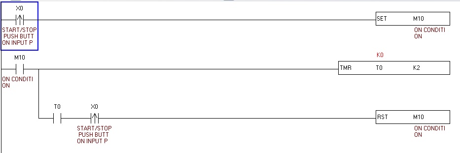

Again we push same button then it get OFF.
