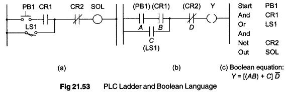

Ladder diagram language is by far the most commonly used PLC Programming Languages.Figure. 21,53, shows a comparsion of the ladder diagram language and the Boolean language programming.
Figure 21.53(a) shows the original relay ladder diagram drawn as it were to be hard-wired. Figure 21.53 (b) shows the equivalent logic ladder diagram that is programmed into the controller. The addressing format shown for input and output devices is generic in nature and varies for different PLC models. Figure 21.53© shows a typical set of generic Boolean statements that could also be used to program the original circuit. This statement refers to the basic AND, OR and NOT logic gate functions.

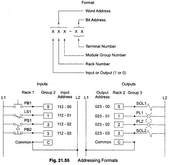

Instruction Addressing
To complete the entry of relay type instruction, an address number must be assigned to it. The number will indicate which PLC input is connected to which input device and which PLC output will drive which output device.
The addressing of real inputs and outputs, as well as internals, depends upon the PLC model used. These addresses can be represented in decimal, octal or hexadecimal number depending upon the number system used by the PLC.
Figure 21.55 shows a typical addressing format. Again, the programming manual of the PLC Programming Languages being used should be consulted to determine the specific format used, as this can vary from model to model, as well as from manufacturer to manufacturer.
