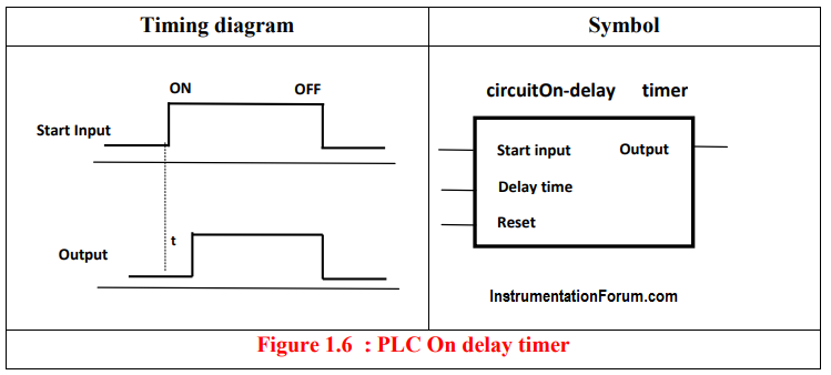

PLC on delay timer :
The timer will be ON state when it recieves a start input siganl and The signal state of output changes to 0 from 1 , when preset timing is reached. The signal state of the output changes from 0 to 1 when preset time has been reached with reference to change of RLO (Result of logic operation) from 0 to 1(ON) at the start input .Functional diagram is shown in below fig.

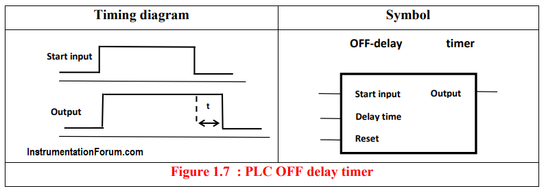

PLC off delay timer :
The timer will be ON state when it recieves a start input siganl and The signal state of output changes to 1from 0 , when preset timing is reached. The signal state of the output changes from 1 to 0 when preset time has been reached with reference to change of RLO from 1 to 0(OFF) at the start input. Functional diagram is shown in Figure 1.7
