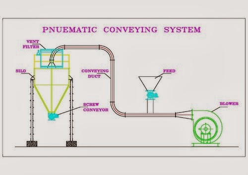

Basic parts of pneumatic conveyor system:
- Blower or compressor
- Feeding device
- Gas/solids disengaging device (Filters)
- Pipe line
Principle of operation:
The pneumatic conveyor system consists of a source of compressed air, a means of feeding the product into the pipeline, and a receiving hopper fitted with a means of separating the conveyed product from the conveying air. The blower or compressor supplies the compressed air to the conveying system. This compressed will travel towards the less pressure side (positive pressure system). The solid material is fed into the air stream by means of feeder device like a rotary valve or screw feeder or venturi feeder etc. There by the solid particles are conveyed to another location by the travelling air. The product is separated from the conveying air by means of filter at the destination.
