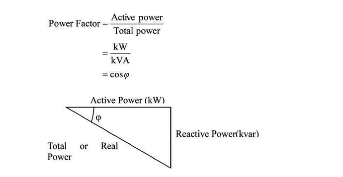

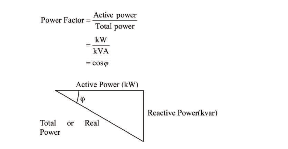

Equipment used in most industries such as drives, controllers, etc., are inductive loads, which lower the power factor. The power factor is the ratio between active power (kW) and total power (kVA), or the cosine of the angle between active and total power. A high reactive power will increase this angle and as a result the power factor will be lower.

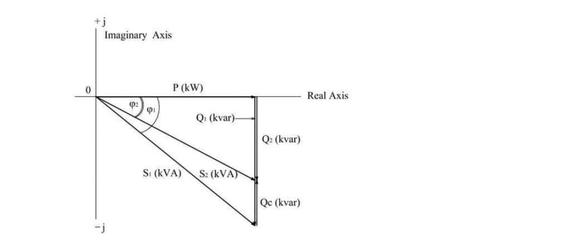

A vector diagram of power factor is shown in Figure

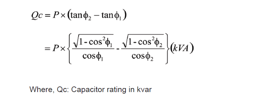

Rating of capacitor to be required for power factor correction can be calculated by the following vector equation.
Capacitor Panel
Capacitor panels consist of some equipment such as condensers for power factor correction, series reactors meters, relays, etc
Where, S1 : Apparent power (kVA) = P – jQ1 (Before correction)
S2 : Apparent power (kVA) = P – jQ2 (After correction)
P : Active power (kW)
Q1 : Lagging reactive power (kvar) (Before correction)
Q2 : Lagging reactive power (kvar) (After correction)
Qc : Capacity of condenser (Advancing reactive power) (kVA)
cosφ1 : Power factor before correction
cosφ2 : Power factor after correction
