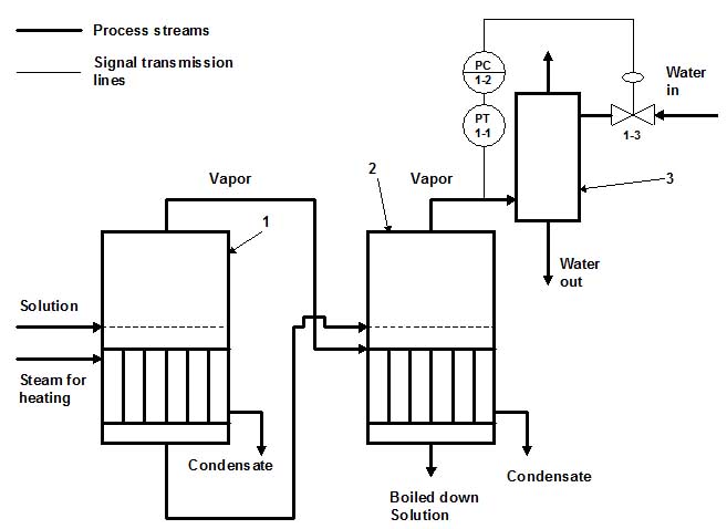

Figure: Pressure control loop for evaporating unit.
1, 2 - evaporating units; 3 - barometric condenser.

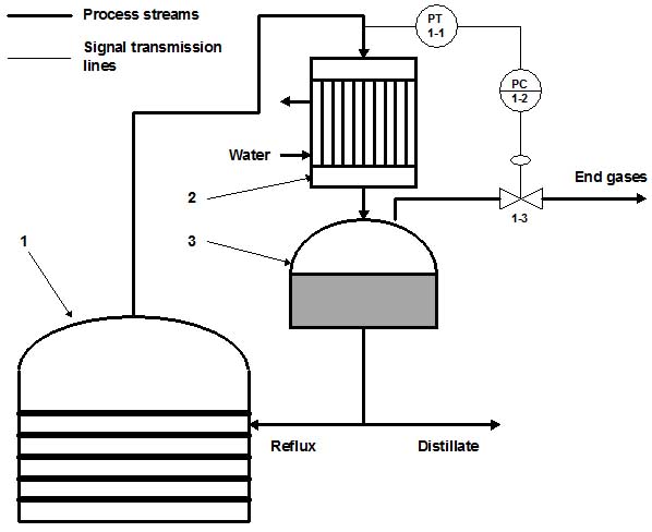

Figure: Pressure control in the distillation column.
1 - distillation column; 2 - reflux column; 3 - reflux tank;
