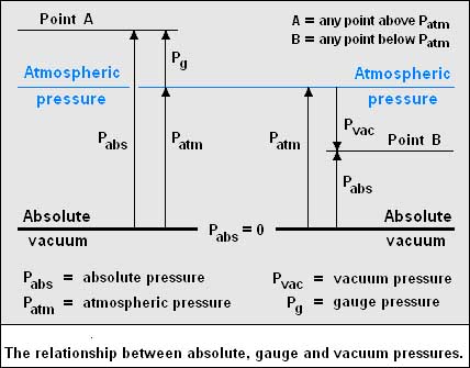

Fig : Relationship between absolute, gauge and vacuum pressures.
