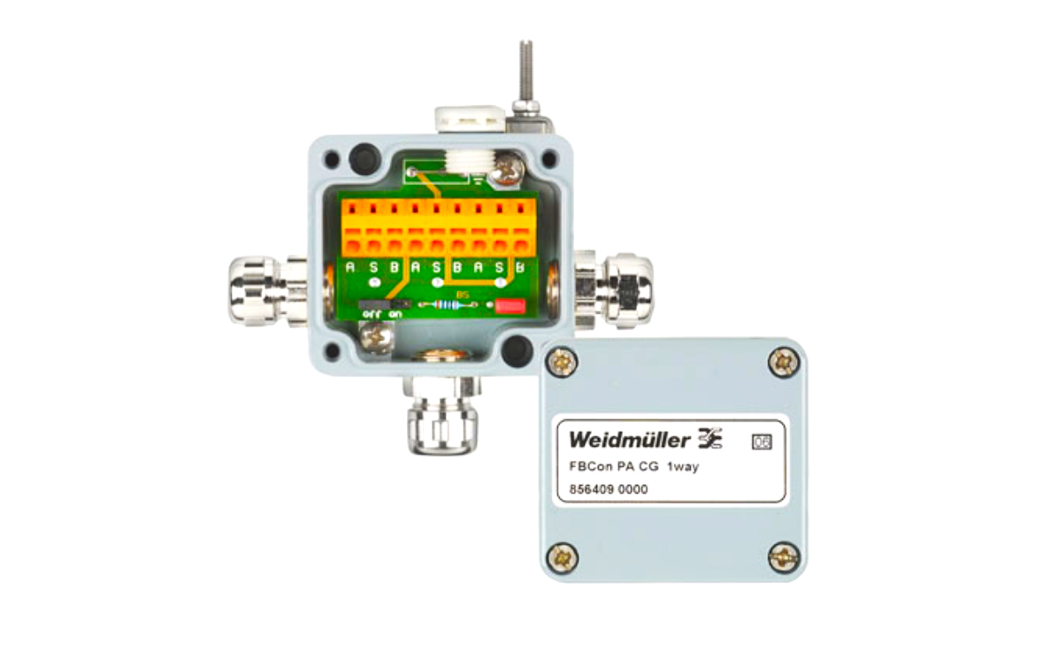

when we need to use Profibus PA junction box ?
I have 8 flow indicator transmitter far away from PLC about 90m , all the instruments are communicating with profibus
do we need to use junction box in such case ?
A Profibus PA junction box is used to connect multiple Profibus PA devices (like your flow indicator transmitters) to a single Profibus cable, simplifying the network topology and reducing the amount of cabling required.
In your case, with 8 flow indicator transmitters located 90m away from the PLC, a junction box could be beneficial. Here’s why:
- Simplified Wiring: Instead of running individual cables from each transmitter to the PLC, you can run a single cable to the junction box, and then connect each transmitter to the junction box. This can significantly reduce the amount of cabling required.
- Easier Troubleshooting and Maintenance: With a junction box, it’s easier to isolate and troubleshoot issues with individual devices. If a device fails, it can be disconnected from the junction box without affecting the rest of the network.
- Scalability: If you need to add more devices in the future, it’s easier to do so with a junction box. You can simply connect the new device to the junction box, without having to run a new cable all the way back to the PLC.
Keep in mind that the use of a junction box should comply with the Profibus PA network design rules, including limits on the total network length, the number of devices, and the power requirements of the devices. Always consult with a qualified engineer or the device manufacturer if you’re unsure.
Remember that the junction box should be suitable for the environment in which it’s installed. For example, if the area is classified as hazardous, you’ll need to use a junction box that’s rated for use in hazardous areas.
