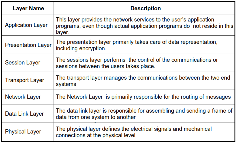

Three of the most important part of a SCADA system is Master Station, Remote Terminal (RTU, PLC, IED) and the communication between them. In order to have good communication between them, there must be a communication protocol.
DNP3 and T101 are two of the most common protocols today. It is important to determine which protocol should be applied if you are planning a SCADA system.
