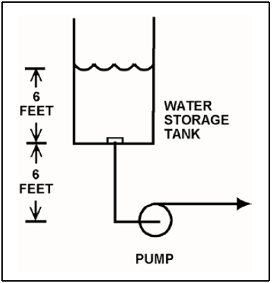

Pump and water level elevations are indicated in the figure. Assume standard atmospheric pressure ___
Refer to the drawing of a centrifugal pump taking suction from the bottom of an open storage tank containing water at 66°F (see figure below).
centrifugal pump taking suction-PG-45
Assume standard atmospheric pressure.
Assuming that pump suction head loss is negligible, what is the approximate value of net positive suction head available to the pump?
A. 6 feet
B. 12 feet
C. 39 feet
D. 45 feet
Answer: D
