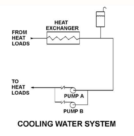

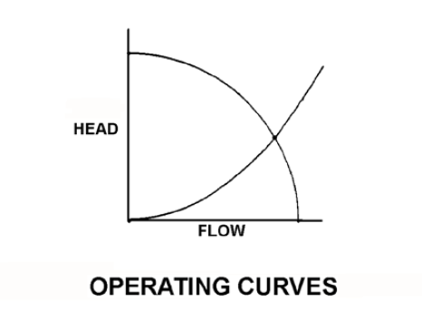

Pumps A and B are identical single-speed centrifugal pumps and only pump A is operating ___
Refer to the drawing of a cooling water system and the associated pump/system operating curves (see figure below).
A cooling water system and the associated pump system operating curves -PG-84-1
A cooling water system and the associated pump system operating curves -PG-84-2
Pumps A and B are identical single-speed centrifugal pumps and only pump A is operating.
If pump B is started, system flow rate will be __________; and common pump discharge pressure will be __________.
A. the same; higher
B. higher; the same
C. the same; the same
D. higher; higher
Answer: D
