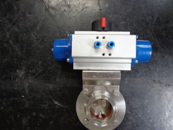

In On-Off Control, An SOV and an actuator is used to control the butterfly valve
on-off control
As shown in the image, air connection is provided to control the valve, also an indication is available showing open and close so that an engineer or technician will come to know it is open or close.
