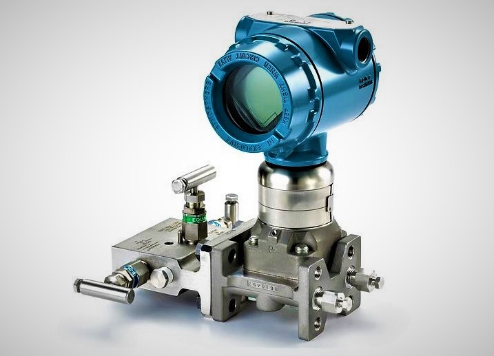

Research specifications for the Rosemount model 3051S Series “coplanar” differential pressure
transmitter (model 3051S CD), located in the Product Data Sheet document (00813-0100-4801 Revision GA, April 2006). Then, answer the following questions:
