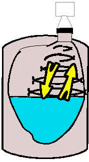

The two technologies on the market are frequency modulated continuous wave (FMCW) or pulsed wave time of flight.
Pulsed Wave systems emit a microwave burst towards the process material, this burst is reflected by the surface of the material and detected by the same sensor which now acts as a receiver.
Level is inferred from the time of flight (transmission to reception) of the microwave signal. Microwave “echoes” are evaluated by sampling and building up a historical profile of the echoes.
FMCW systems, however, continuously emit a swept frequency signal and distance is inferred from the difference in frequency between the transmit and receive signals at any point in time.
FMCW is therefore the only method that is suitable for the high accuracy’s demanded for tank gauging.
