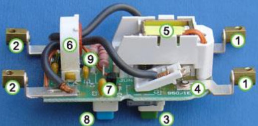

The incoming supply and the neutral conductors are connected to the terminals at (1), and the outgoing load conductors are connected to the terminals at (2). The earth conductor (not shown) is connected through from supply to load uninterrupted. When the reset button (3) is pressed, the contacts ((4) and another, hidden behind (5)) close, allowing current to pass. The solenoid (5) keeps the contacts closed when the reset button is released.
The sense coil (6) is a differential current transformer which surrounds (but is not electrically connected to) the live and neutral conductors. In normal operation, all the current down the live conductor returns up the neutral conductor. The currents in the two conductors are therefore equal and opposite and cancel each other out.
Any fault to earth (for example caused by a person touching a live component in the attached appliance) causes some of the current to take a different return path, which means that there is an imbalance (difference) in the current in the two conductors (single-phase case), or, more generally, a nonzero sum of currents from among various conductors (for example, three phase conductors and one neutral conductor).
This difference causes a current in the sense coil (6), which is picked up by the sense circuitry (7). The sense circuitry then removes power from the solenoid (5), and the contacts (4) are forced apart by a spring, cutting off the electricity supply to the appliance.
The test button (8) allows the correct operation of the device to be verified by passing a small current through the orange test wire (9). This simulates a fault by creating an imbalance in the sense coil. If the RCD does not trip when this button is pressed, then the device must be replaced.

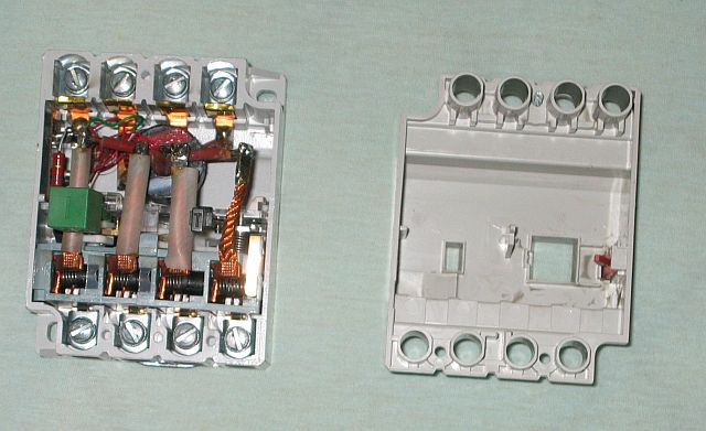

For an RCD used with three-phase power, all three live conductors and the neutral (if fitted) must pass through the current transformer.

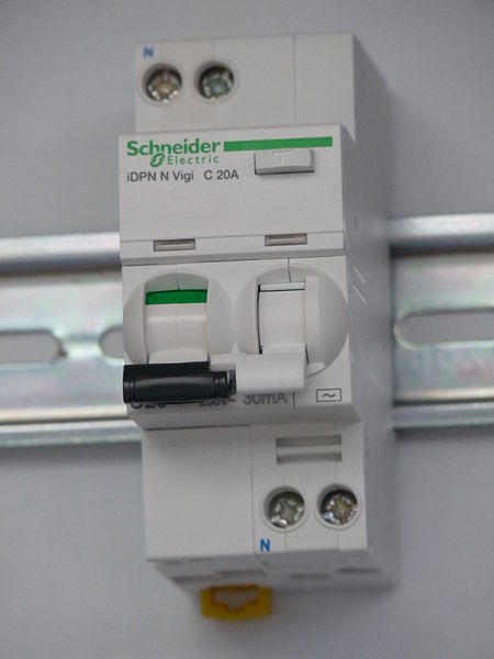

RCBO
A pure RCD will detect misbalance in the currents of the supply and return conductors of a circuit. But it cannot protect against overcurrent (overload) or short circuit like a fuse or a miniature circuit breaker (MCB) does (except for the special case of a short circuit from live to ground (not live to neutral)).
However, a RCD and a MCB often come integrated in the same device, thus being able to detect both supply imbalance and overload current. Such a device is called
  • RCBO (for residual-current circuit breaker with overcurrent protection ) in Europe
  • GFCI breaker (for ground fault circuit interrupter ) in USA and Canada and
  • Safety Switch or RCD in Australia.
