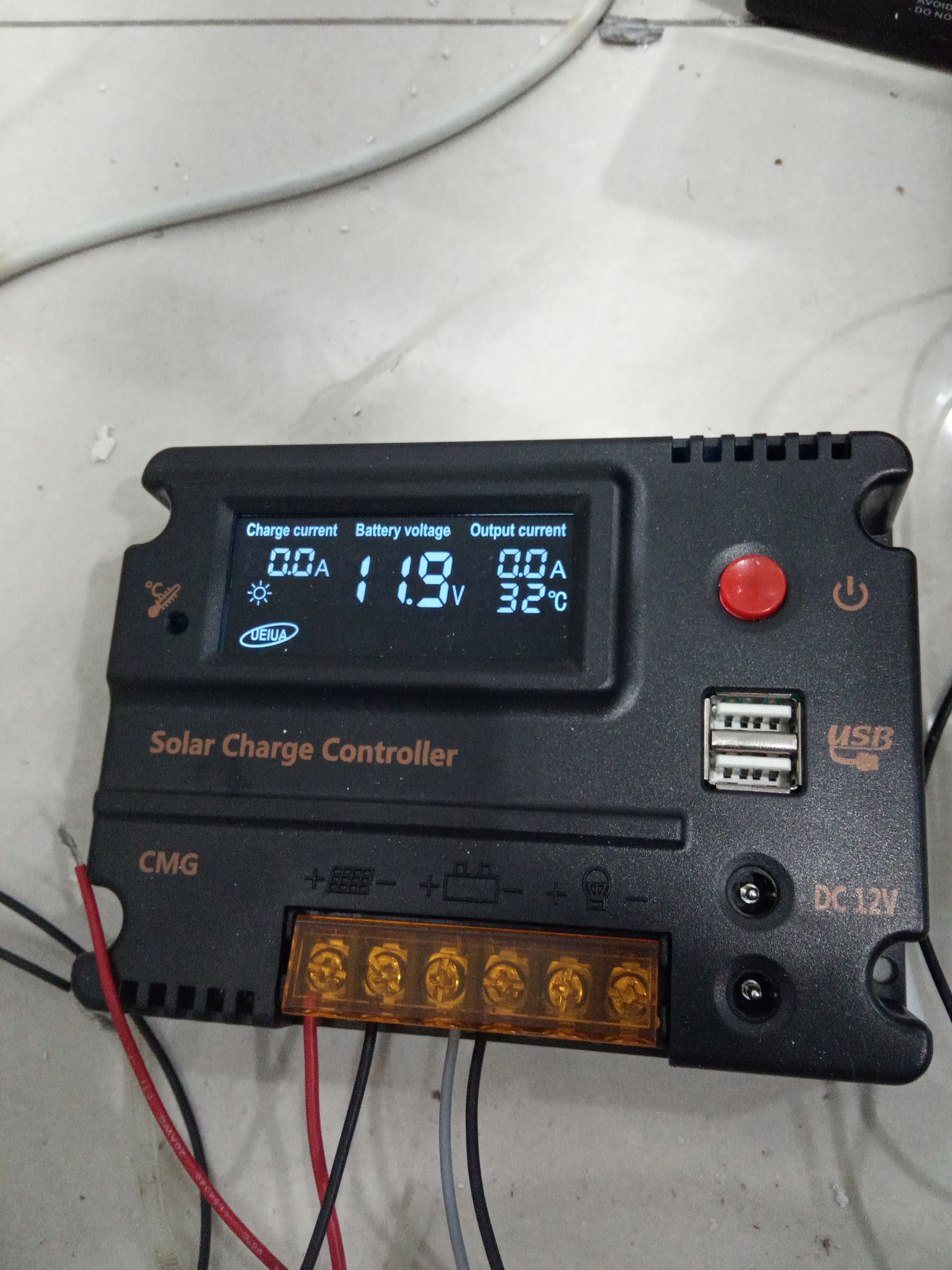

Ok Sir, I have solar panel 9 V 3 W store in rechargable battery 7.8 V, I have problem the voltage is drop when coonnect to input battery . Can I get the proper wiring ?
I test with motor dc but the Ah not decrease, I want to know recharge & discharge system in rechargable battery

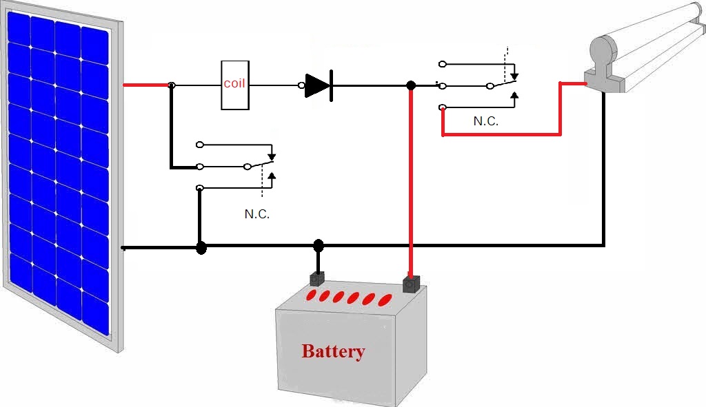

First of all battery is not-charged; diode will be forward biased as potential at battery is low will charge the battery & as coil is excited N.C. contacts will be opened,
As battery charges to fullest potential diode is reverse biased coil discharges & contacts come back to initial state, hence solar panel will be short circuited & battery supplies the load.
1.Ok Mr Sandeep , what is type of diode ? IN 4007? So I need relay with 2 contacts ( normally close ).

Is Solar Charge Controller PWM type ?
No, Pulse Width Modulation (PWM) not required for solar charge controller. Its simply a DC to DC converter.

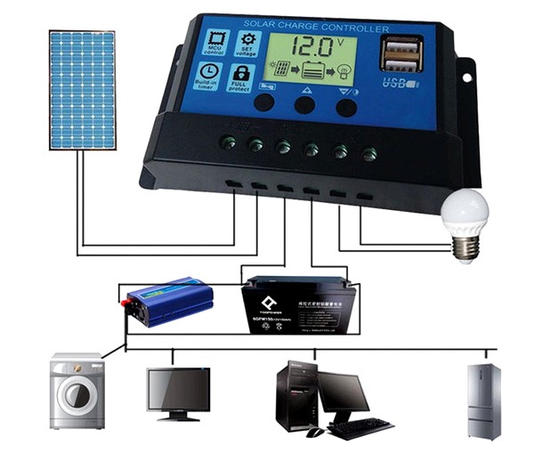

OK Mr Santhosh , May I ask you , is there inverter DC to AC 3 phase ?
Yes, DC to AC converter might be PWM type for handling AC loads but solar battery charger requires DC to DC converter. Inverter need to be provided externally for the purpose.
