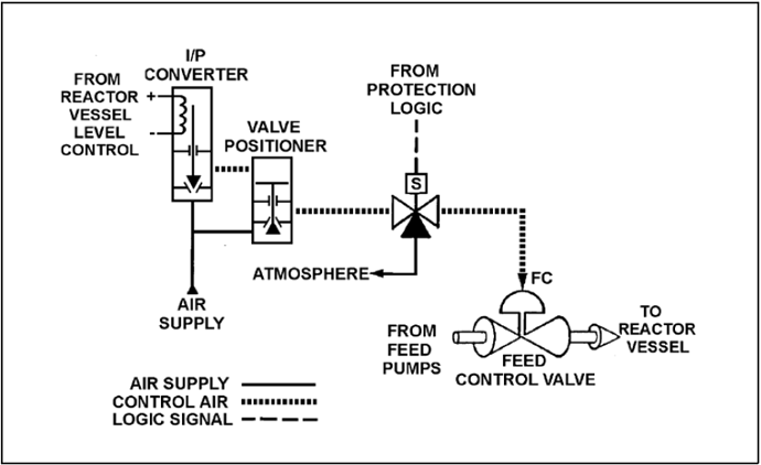

Refer to the drawing of a pneumatic control system. The purpose of the valve positioner is to convert ___

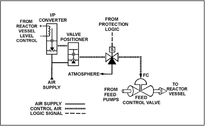

Refer to the drawing of a pneumatic control system (see figure below).
The purpose of the valve positioner is to convert…
A. a small control air pressure into a proportionally larger air pressure to adjust valve position.
B. a large control air pressure into a proportionally smaller air pressure to adjust valve position.
C. pneumatic force into mechanical force to adjust valve position.
D. mechanical force into pneumatic force to adjust valve position.
Answer: A
Answer is A
