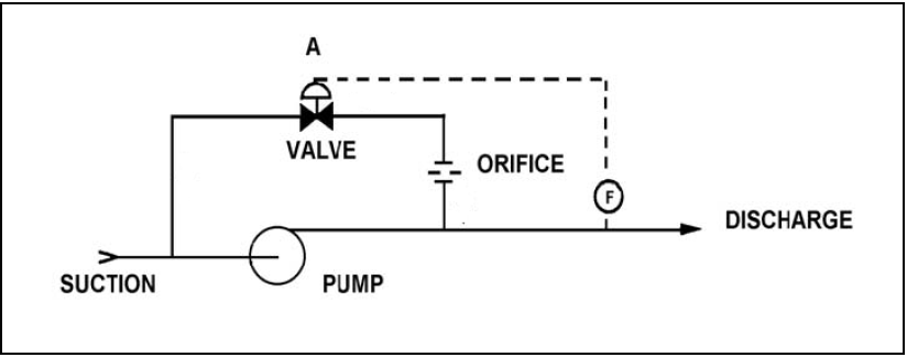

Refer to the drawing of a pump with a recirculation line (see figure below).
Valve A will open when pump…
A. discharge pressure increases above a setpoint.
B. discharge pressure decreases below a setpoint.
C. flow rate increases above a setpoint.
D. flow rate decreases below a setpoint.
Answer: D
