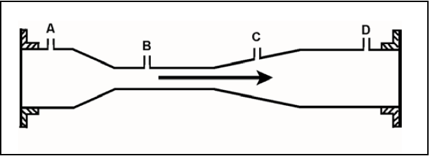

Refer to the drawing of a venturi flow element (see figure below) with direction of water flow indicated by the arrow ___
Refer to the drawing of a venturi flow element (see figure below) with direction of water flow indicated by the arrow.
Venturi Flow Element
Where should the high pressure tap of a differential pressure flow detector be connected?
A. Point A
B. Point B
C. Point C
D. Point D
Answer:A
