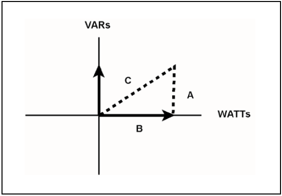

Refer to the drawing of an electrical system power triangle (see figure below).
Which one of the following represents the power factor for this system?
A. A divided by B
B. A divided by C
C. B divided by A
D. B divided by C
Answer: D
