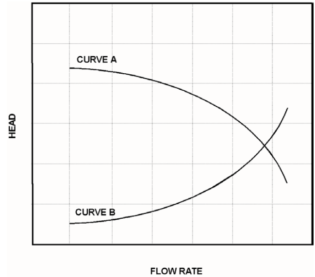

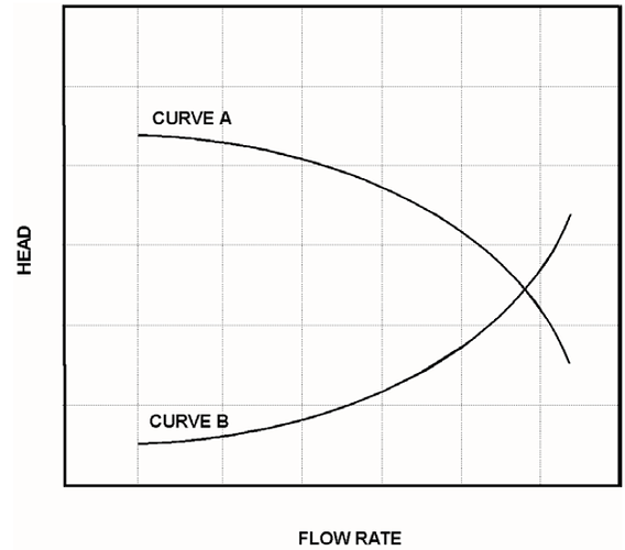

Refer to the graph that represents the head-capacity characteristics for a single-speed centrifugal cooling water pump (see figure below).
Which one of the following lists a pair of parameters that could be represented by curves A and B?
(Note: NPSH is net positive suction head.)
Answer: B
