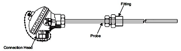

Selection depends on the nature of the medium being sensed and cost requirements. Direct immersion of a probe into a liquid requires a fitting with a pipe thread, which may be adjustable or welded on the probe.
Figure shows a typical assembly, with one thread for mounting the probe and another for a connection head. Connection heads provide a transition between probe leads and external signal wires.
