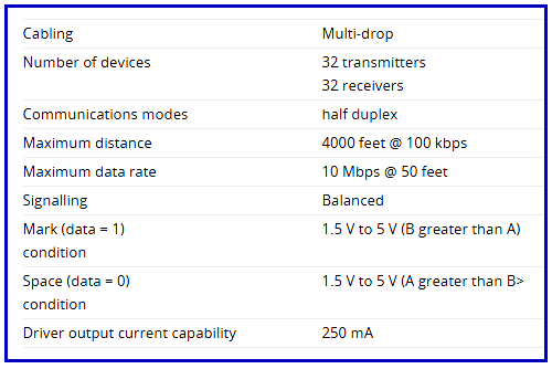

RS485 specification overview
The table below provides the highlight details behind RS485.
