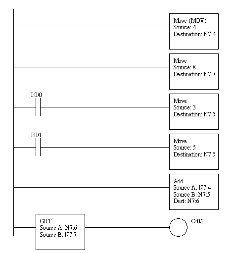

• Instructions:
- Now we will write a program that adds two numbers. If the sum is greater than 8 then an output will turn on. Enter the ladder logic and run the program. Watch the values displayed, and notice how inputs I:0/0 and I:0/1 change the values.
