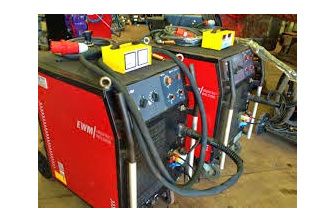

What are the required Safety Inspection Check for Welding Machine and mention the steps involved in checking.
Spark arrestor
Insulation system of exhaust
Electrical/ welding cable connection
ESD. system
Socket/ Power supply connector
Electric cable insulation
Cable grounding system
Ampere indicator
Safety guarding system
ELCB (30 mA) installed
Battery covered
Engine and fuel system leaks
Lifting point/ pad eye condition (certified)
Fire extinguisher ( stand by when use)
General condition
Inspection sticker
