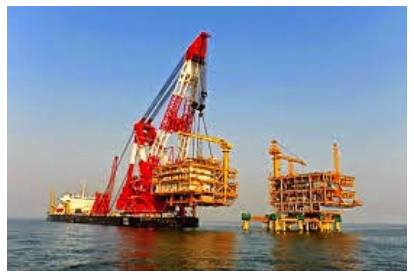

What are the required Safety Inspection Check for Work Barge and Crane Barge and mention the steps involved in checking.
Life Raft 100 % of POB each side (condition & validity), Life Jacket ( 125% of POB), Ring buoy (marking, ropes, light), Cleanliness, Radio and radio operator certified, Radio communication (function test and log book available in radio room),
Fire pump with sufficient hydrant/hose, Fire Extinguisher (label, pin, hose), Smoke/heat detector (function test), Safety guard of rotary machine, Exhaust insulation system of engine, ERT (Emergency response team available on barge and clearly displayed), ERP (Emergency Response Plan) clearly displayed, Badge board and badge system, visitor log book, Electric cable and battery (connection & insulation), Emergency siren and code displayed,Safety Sign (escape way, muster point),First aid kit (medicines stock, list used of it), Emergency light (engine room, gang way, clinic), ESD (main engine, generator), grounding system, Spark arrestor (if use within DKP area), Clinic and facility, Enclosed space ventilation & safety matter inside, Lifting Equipments (winches, hose gears, etc), Escape route to muster point kept clear (no obstruction), Safety equipment lay out displayed
