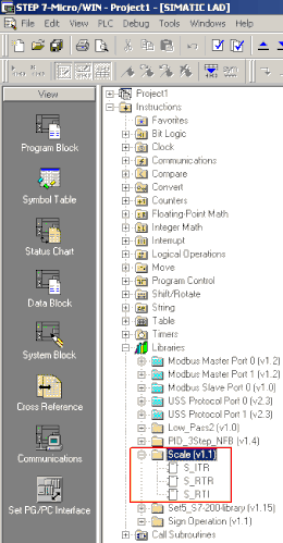

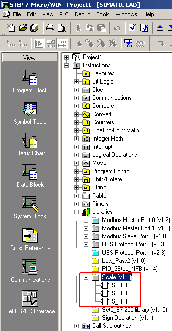

3. Library
3.1 Description of the “Scale” library
The “scale.mwl” library contains the function blocks for converting the scaling from data type INTEGER to REAL (S_ITR), from REAL to REAL (S_RTR) and from REAL to INTEGER (S_RTI).
