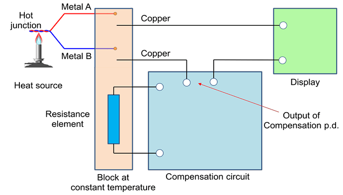

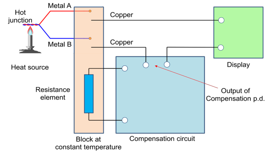

Schematic of Thermocouple Circuit
Figure shows the schematic of thermocouple circuit. The net open circuit voltage (the Seebeck voltage) is a function of junction temperature and composition of two metals. It is given by,
where α, the Seebeck coefficient, is the constant of proportionality.

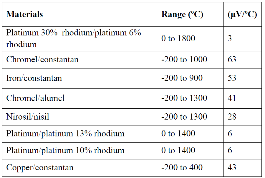

Generally, Chromel (90% nickel and 10% chromium)–Alumel (95% nickel, 2% manganese, 2% aluminium and 1% silicon) are used in the manufacture of a thermocouple.
Table shows the various other materials, their combinations and application temperature ranges.
Thermocouple materials and temperature ranges
